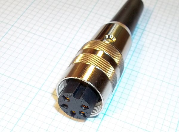

The Lumberg KV50/6 is a 240 degree, 5 pin DIN connector available from Allied Electronics.
By removing the pin block and filing it to fit inside the tonearm you can "bootleg" an expensive over-priced "tonearm" connector.
Allied has the Lumberg KV50/6 for about $9: http://www.alliedelec.com/lumberg-kv-50-6/70151666/
All Electronics currently have them surplus for around $3: http://www.allelectronics.com/make-a-store/item/din-5f/female-5-pin-din-connector-in-line-locking/1.html
Based on the prices of DIN females specifically made for tonearms the above seem very reasonable.
The connector pin block has to be modified slightly to be a DIN tonearm connector.
It takes a couple of minutes at most.
Lumberg KV50/6 5 Pin 240 Degree Female Locking DIN Connector

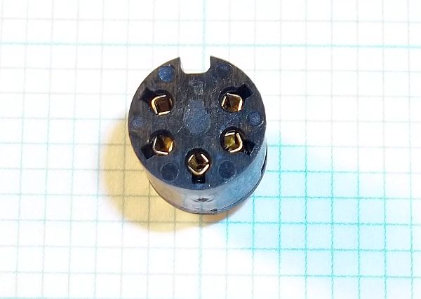

The pin block has to be removed from the outer metal shell which will be discarded.
Tabs extending from the back of the pin block interlock into an insulating plastic shell that is also not used.
The tabs interfere with insertion of the connector body into the tone arm.
Filing them off to make the end of the pin block round allows clearance.
Apparently this is what makes DIN tone arm connectors "special."
Lumberg KV50/6 5 Pin 240 Degree Female Locking DIN Connector Modified Pin Block

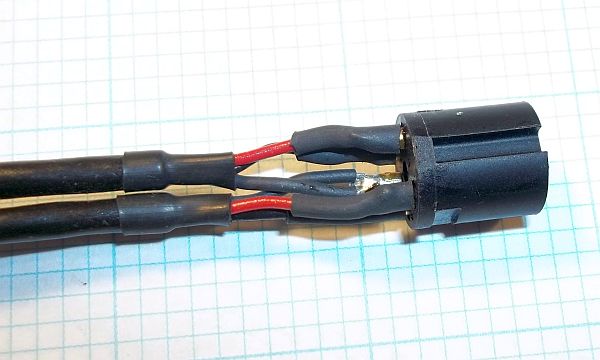

Once the pin block has had the plastic tabs filed down with the body completely circular it can be used to make balanced phono cables:
Lumberg KV50/6 5 Pin 240 Degree Female Locking DIN Connector Modified Pin Block With Leads
The assembly slips into the Audio Dynamics tonearm.
I realize that the Brand-Rex cable I used isn't made of unobtainium: I could have paid $229 if I wanted unobtainium.
