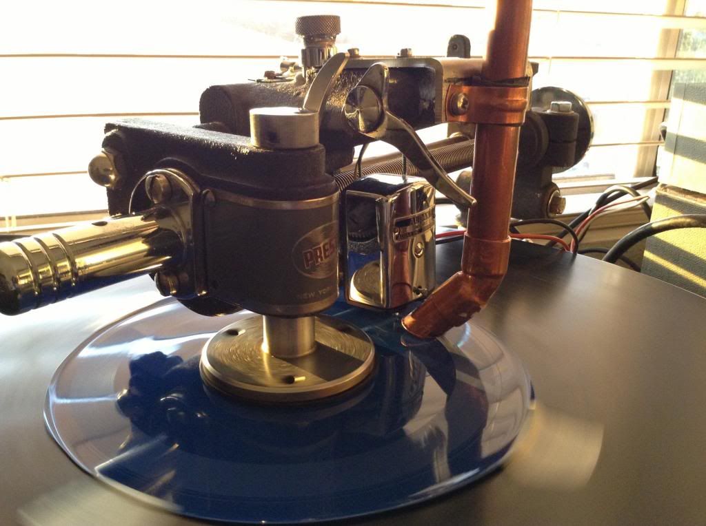

Vacuum on 6n
I just added a vacuum to my presto 6n. I am using a small eureka! Rally2 vacuum hooked up to a light dimmer switch. The switch controls the vacuum suction and lowers the vacuums loudness.
I used some copper tubing and some metal laying around the house to attach it to the lathe.
It took some time to get it set up in the right area to suck up the swarf. But i almost got it dialed in.

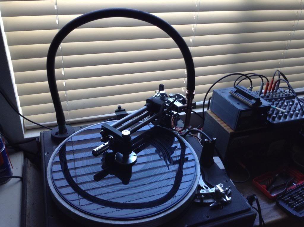

Presto with vacuum
Heres my presto finally dialed with the vacuum
Re: what vacuum to use?
http://youtu.be/rUKoQ6mQKvg heres the vacuum in action with the presto 6n.
