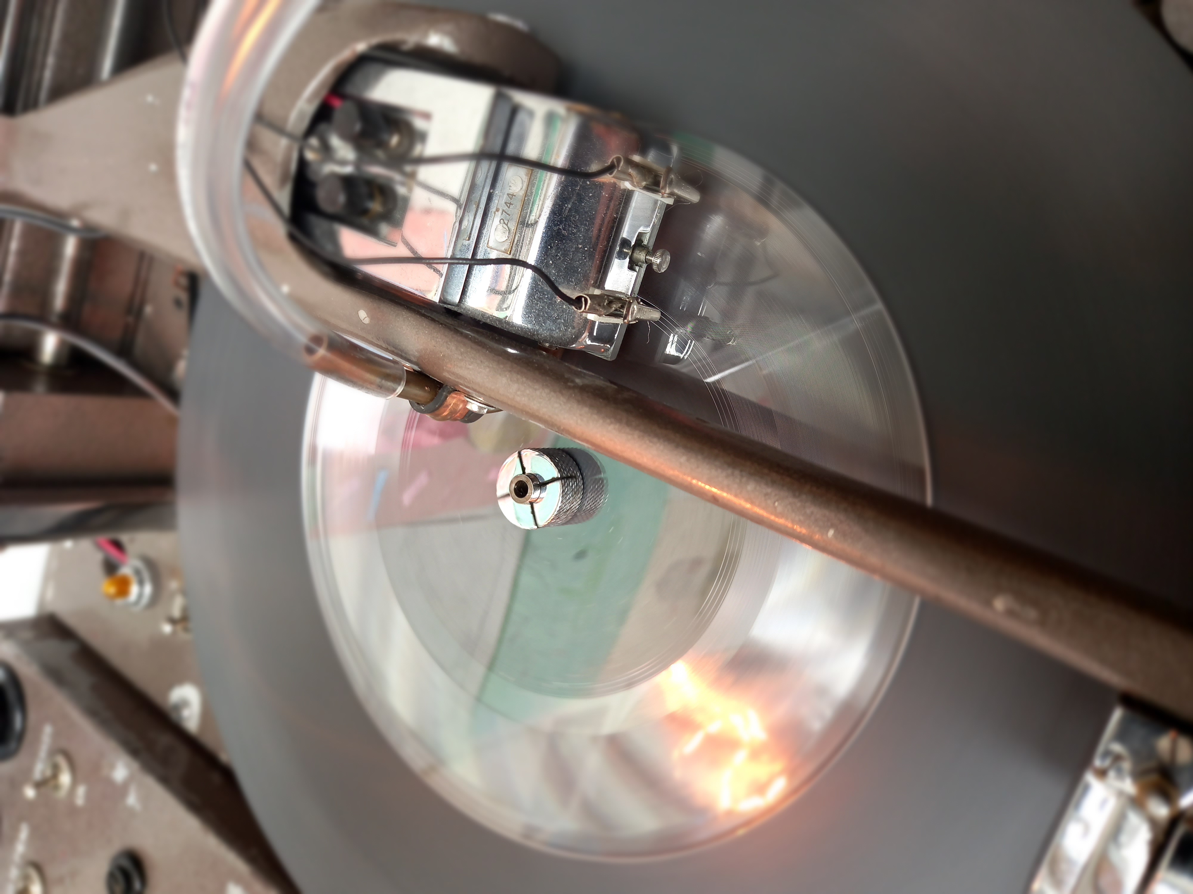

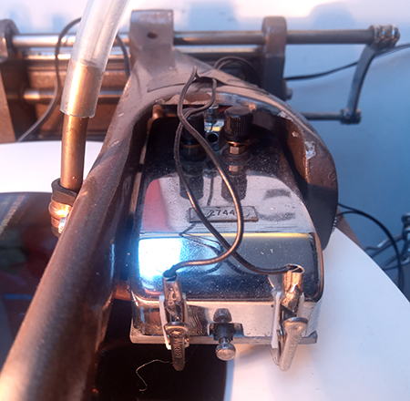

i will get a photo of the cutterhead

Post: # 58848Unread post nikc
Thu Jun 24, 2021 3:32 am
Nik Clifford
