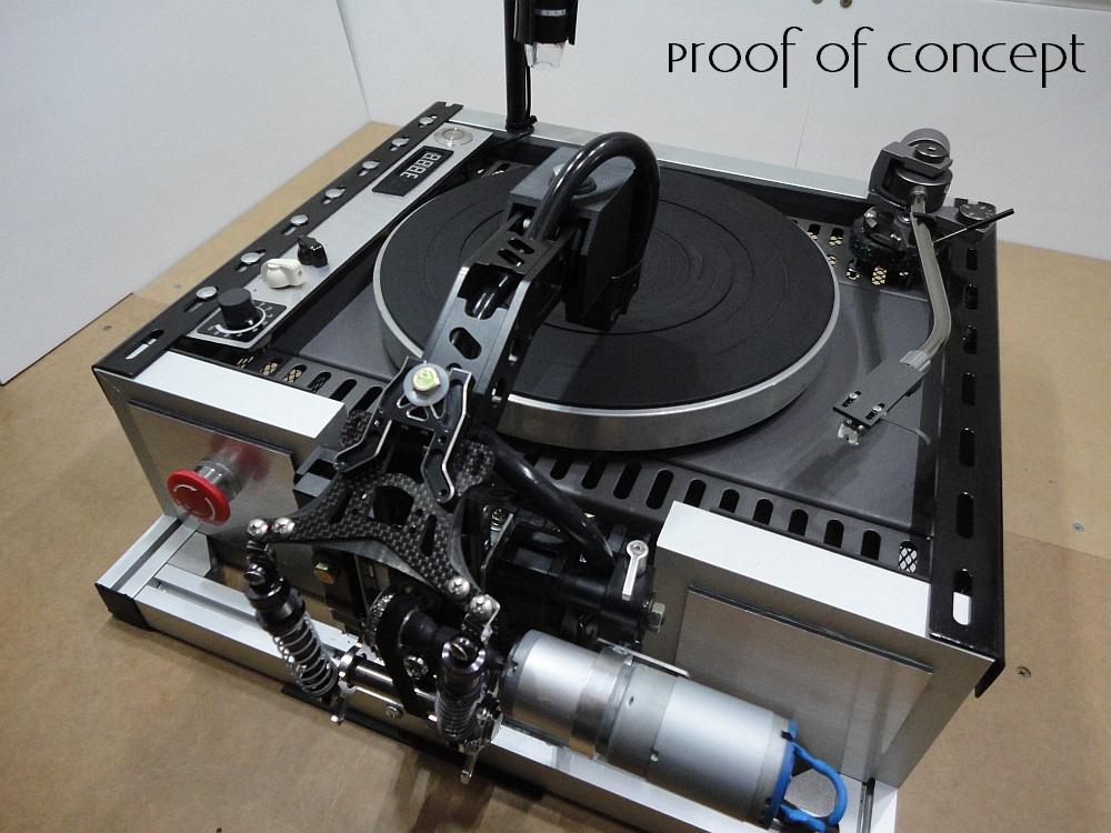

Hi All...
I’ve been offline for a while (long story), but you may know me from my Butler Mastering days. I’ve since ceased mastering to work full time on developing audio products under this name... speaking of which...
I’ve been dedicated to a project [I’m hoping] you will be interested in. Developing a Desktop Record Cutter [or proof of concept at least] to launch on KickStarter shortly.
I wanted to post here first, out of respect for you... my peers. After all, it is the Trolls that have nurtured this obsession...
...which I thank you all for!
If KickStarter is successful, I’d like to start discussion in this forum as to final feature set and interface. We will see how it goes I guess :) The beauty is, the more raised, the larger we can scale, and the cheaper it will get. Currently, we are circa US$6,500 for a complete system, but we can bring this down significantly with more involvement.

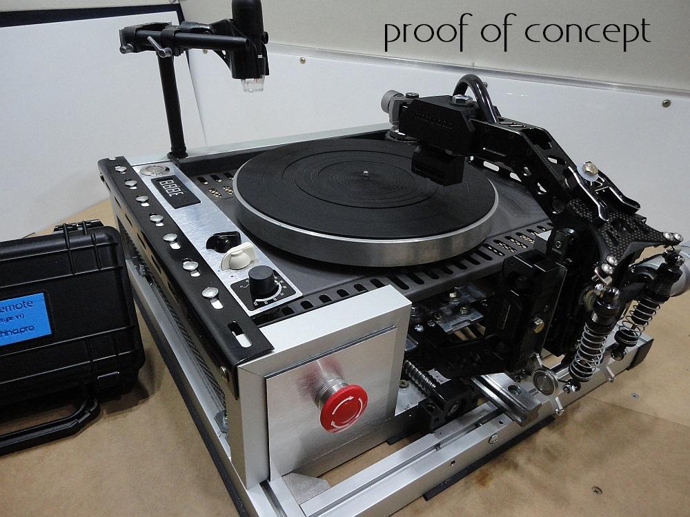

The video below does show a retro-fit turntable but we are VERY close to having our own high-torque turntable integrated (yes, out spec’ing the SP-02, and yes, it will be available separately). We are working on integrating vacuum clamping and also experimenting with platters from solid brass, acrylic, aluminium or a combination of materials, possibly in a Pro 14” version also, anyway, the overhead...

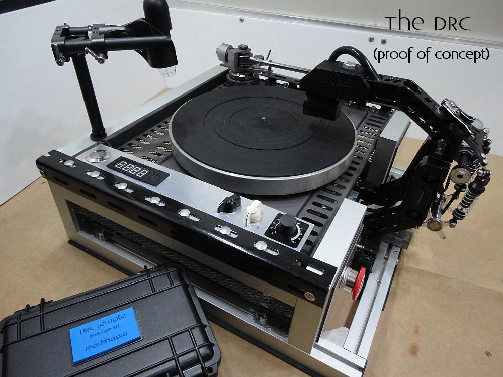

Dubbed the DRC, our Desktop Record Cutter is capable of cutting vinyl and/or vinyl-like material. It is automated using modern technology for ease of use, but will allow custom control, upgrades and modification for the experienced user.
With universal head mounting (and a modular frame) it is designed to work with any head. BUT, we are in discussions to either OEM an existing head, or partner with someone who is also in development (more info to come... very soon).
So yes, THIS WILL BE A COMPLETE CUTTING SYSTEM, and yes the estimated $6,500 includes an allowance for a head and electronics/drive package... audio in, cut.
The DRC has an integrated LCD, posses multi-axis digital control and I’ve also managed to integrate (via in-house 3D printed and CNC cut components) a load cell, capable of measuring cutting force (both outputted digitally for display as well as a control parameter for automation). The cutting motion allows more than 7" of movement BTW, so it could be capable of 14" Masters (or it just gets right out of the way to enjoy some listening :) ).
Not yet connected in the video, but we have a vacuum system integrated, allowing clean cutting. The vac motor included has dual I/O, so we have space for vacuum clamping, or something that can be connected elsewhere by the user.
Sensing is way overboard at the moment... if I add any more it may just rise up and take over the world :D
We have motion sensing of turntable to activate cutter, ultrasonic, IR, photo-sensing and even some (robot) line sensing technology have all been tested. We are scaling this back to the most accurate and cost effective currently, and will also allow complete manual control for advanced override and function.
I know I am somewhat out on a long ethenyl limb here, my intentions truly are in the interest of vinyl as a medium (and analogue playback in general). This is most definitely a business of passion for me, not profit focused and I welcome any constructive feedback (“no man is an island”).
Pictures below of the proof of concept (close, but this is still a work in progress)... and here is a quick video (excuse the editing and capture, I’m an audio guy :D ).

Looks interesting...are you saying that arm will support a Westrex head?

On Westrex Head Support... I've mocked one up but I need to spend a little more time on this.
The head mounting component is currently being "printed" in Nylon... I'm experimenting with a CNC cut alloy mount with 3D printed damping internally. There's a cool filament I've been messing around with called Ninja-Flex, it's proving promising for this application.
My intentions are to have a universal mount capable of accepting as many heads as possible. I understand the Westrex is a different config though so I will most likely release an independent support for this.
I'm pretty set up as far as design and production goes currently... I'd be able to turn head support requests around within 48 hours (the joys of modern technology) :D

So . It comes with an Audax cutter head? As I see in the picture....

You can have an Audax if you like, as mentioned, this is proof of concept only and the system will include a Stereo Cutter-head and electronics.

Is this a direct drive motor?
Modified existing motor/repurposed from another device? Or custom made for disc cutting?

Yep, direct drive. The coupling/spindle are undergoing a re-design right now (literally) while we wait for the remaining parts.
It's a hybrid of the two I guess, I've specified and tested a custom motor... the prototype is good but the packaging/structure were not suitable.
So it's currently being laid out into a re purposed housing...
So... Custom Spec Guts in a re-purposed enclosure

if motor has a torque of 450 kg cm thats then only the very modest power of
M= 450 kg/cm = 44Nm
P=2 x Pi x M x RPM = 12 kW @ 45 RPM. thats quite amazing!
does the cutterhead get another 10kW for best performance?
why not just build something thats close to what is promissed and then
post some pictures, sounds
and then go kickstarter?
the linear actuator is the simplest thing of any cutting lathe.
a nice strong& quiet turntable,cutterhead, amps, vacuum and a nice concept might be a litte bigger task.
