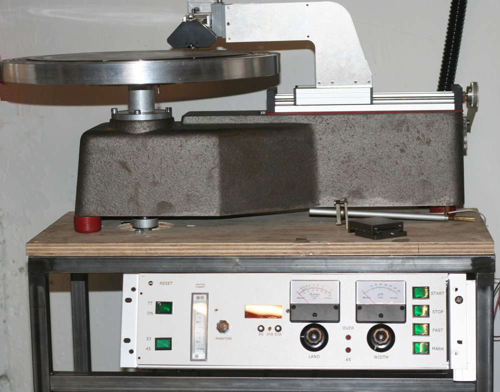

We have recently acquired the first AM44 to leave the Flokason labs. It features a Neumann AM32 body, a 16" vacuum platter, TT15 motor, Pitch13, and a lot of prototype parts. We are using the Caruso head with its preamp and some custom modified-by-Magnetovolt cutting amps, which are solid-state at present, while our tube disk mastering electronics are being tested and developed.
The dark red color is our own take on this.
Much more to follow soon!
The entire crew, with its new toy.
Adjusting the suspension.
The setup process, without suspension.
Checking the gastrointestinal situation.
16" vacuum platter.

Re: Neumann /Flokason AM44/ Pitch13/ Magnetovolt Electronics
Hi Jesus,
Congratulations on your acquisition of a brilliant cutting system from Flo. I hope you enjoy many, many, years of cutting great music on it. I'm not ordinarily jealous of anyone or anything but (Sighs) If only!!! Te He
here a few recent pictures of
what a standard AM44 looks like at the moment.
after 2 pre series machine most parts are defined and there is a highend and a semipro machine.
starting from around 15k to whatever you want......
vacuum platter will be 14" in future except you really want a 16inch.
linear slide is the one on the picture or for pro version a neumann like. same dimensions. dovetail. grey cast heavy duty.
table is wood for semipro and stone (granite) for highend machine
pitch13 is not standard for semi pro machine.
TT15 is on the floor.
TT bearing is a 20mm shaft with axial ball bearing and 2 sinter bronce bearings
surface of the rack is 660x300mm
more on the flokason news site.
happy cutting.

Nice!flozki wrote:here a few recent pictures of
Looks like it is quite a compact package in this form. Good looking control panel, too.
Yup, there is more were these two came from!flozki wrote:more on the flokason news site.
happy cutting.
