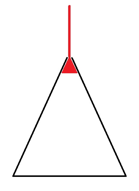

Regarding ball screws, I considered "upgrading" the half scale VMS 70 to ball screws but abandoned it as an idea due to concerns over noise.
The VMS 70 saddle actually does run on ball bearings (which I did not know when I made the half scale model). If I had known, I suspect I still would not have used ball bearings because the ball bearings used by Neumann were undoubtedly "special" and made for their application. Sourcing such bearings, even if I knew what they actually were would have been difficult and expensive.
The only change I made was I cut the lead screw nut from an "Asonic" plastic bearing material.
You might consider this material as a replacement for the linear guides.
https://www.igus.com/info/linear-guides-low-noise
I discounted the use of stepper motors from the start as I know they're noisy and opted for a brushless EC servo motor & controller from Maxon.
I haven't made a cone yet but I have thought about it & the attachment point of the force transferring rod has always seemed to be an obvious point of failure.
I had considered turning this rod from a larger section but leaving a flared end to A) cause better axial location inside the cone B) prevent separation failure.
http://www.wilsonlogan.com/images/flared-cone.jpg
I like your idea of turning the part as one piece better but recognise how difficult such a thing is to make.
I'm not sure if this would be easier but you might consider metal spinning. I have made some experiments with metal spinning on my lathe and TBF, the results were not good but I was trying to spin parts which required much heavier metal than you would need.

At first I also thought about improved ball bearings and then came up with "Asonic" plastic bearing material. It turned out to be an excellent solution (I will write about it in one of my next reports).
evildrome wrote:
Sun Jan 07, 2024 6:42 am
This cone solution is certainly better for split cone-rod drives. But the weight and the glue must always be taken into account. So don't leave too much flared end.
