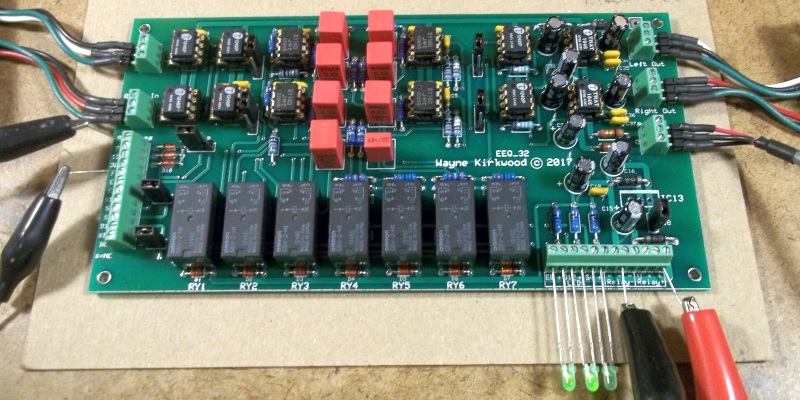

After being asked by a couple of customers to make a board I did.
This is the completed Elliptic Equalizer PC board.
The EEQ board has an optional on-board MS codec or it can be jumpered to receive MS inputs directly as an insert to the Precision MS Matrix. In the later configuration only the 4 dual op amps are used. The rest of the "stuff" is balanced I/O and MS.

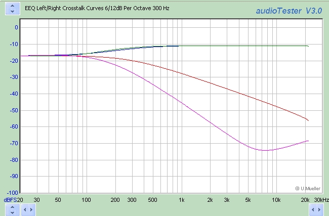

Comparison of 6 dB vs. 12 dB Per Octave Crosstalk Response
Left-only input. EE set at 300 Hz.
Top trace is left out.
Bottom traces are the right channel crosstalk with the EEQ plotted at 6 dB and 12 dB per octave
Second-order Elliptic Equalizer Crosstalk Comparison at 300 Hz with 6 or 12 dB per octave slope
The final curve (above) shows the vast reduction in crosstalk of the 12dB/octave slope.
